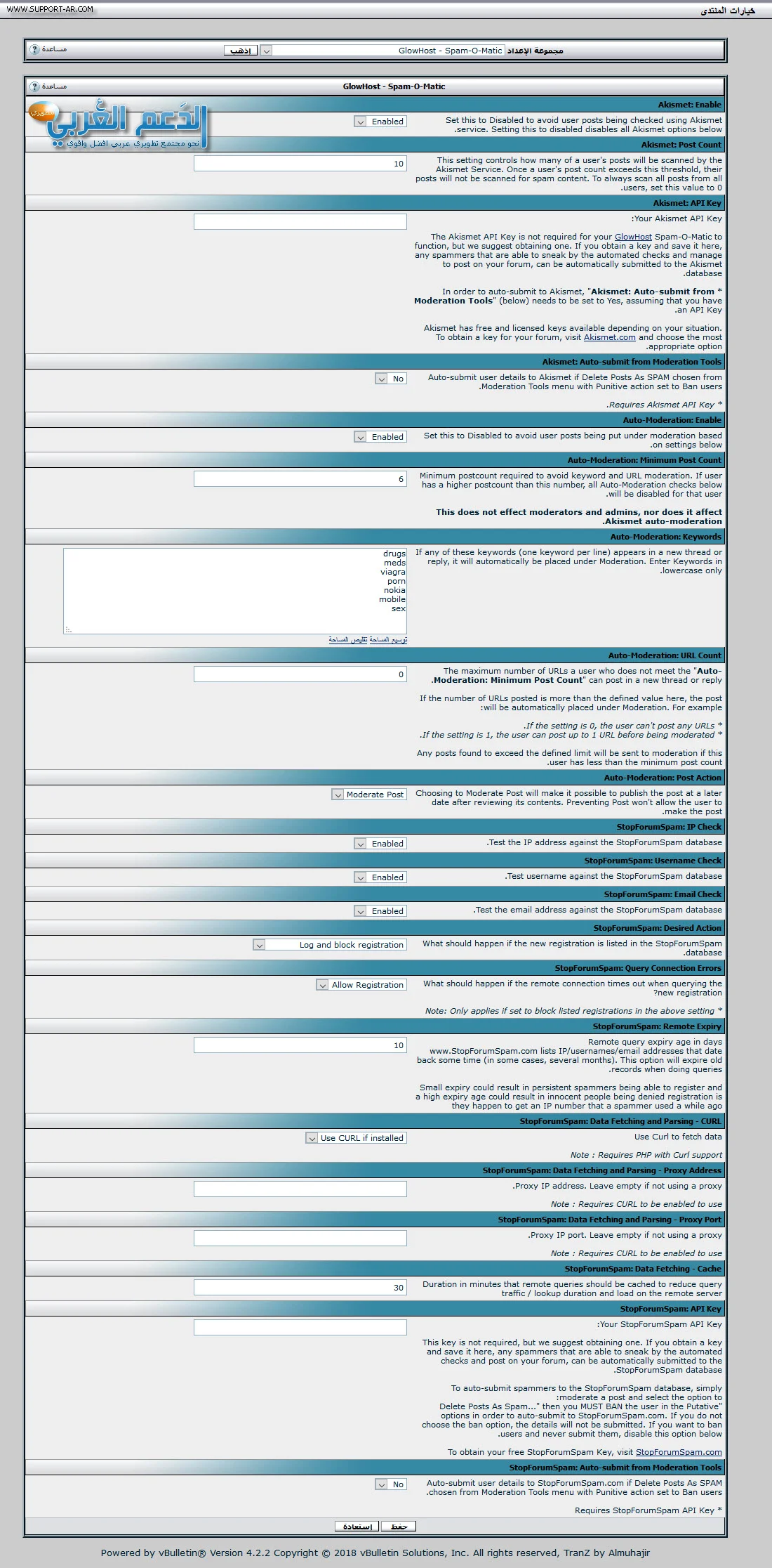

This module has the ability to submit new spammer details to the StopForumSpam or Akismet databases automatically, all without any new templates or manual template modifications!
Just install the product in the product manager, upload a few files, configure the system and you are done. (Estimated time: 5-10 minutes)
How it works:
New registrations are checked against the known spammer database at StopForumSpam.com. If the email, IP, or username exists in their database, the user (or bot as the case may be) is denied registration on your forums. If they make it past the SFS check, they are checked against several Automatic Moderation rules, and are also checked against the Akismet service for known comment spam.

The Akismet settings let you:
Set the number of posts that Akismet will check from each user. After this number is exceeded, Akismet checking will be disabled for that user.
Auto-Submit spammers that post on your boards back to the Akismet service so that other forums and blogs do not do not receive the same spam.
Completely disable the Akismet service.
